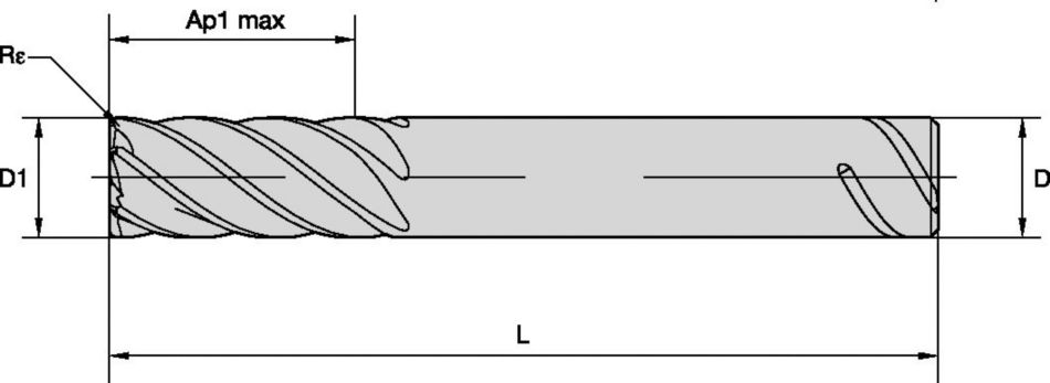

  • Tool Dimensions: Flute Configuration: 6Tool Dimensions: Flute Configuration: 6
Drawings for 5351824
Material Number5351824
ISO Catalog IDUJDE500N6BRB
ANSI Catalog IDUJDE500N6BRB
GradeKCSM15
Adapter Style Machine SideSAFE-LOCK
[D1] Effective Cutting Diameter12.7 mm
[D1] Effective Cutting Diameter0.5 in
[D] Adapter / Shank / Bore Diameter12.7 mm
[D] Adapter / Shank / Bore Diameter0.5 in
[AP1MAX] 1st Maximum Cutting Depth31.75 mm
[AP1MAX] 1st Maximum Cutting Depth1.25 in
[L] Overall Length 76.2 mm
[L] Overall Length 3 in
[Re] Corner Radius 0.75 mm
[Re] Corner Radius 0.03 in
[Z] Number of Flutes6
