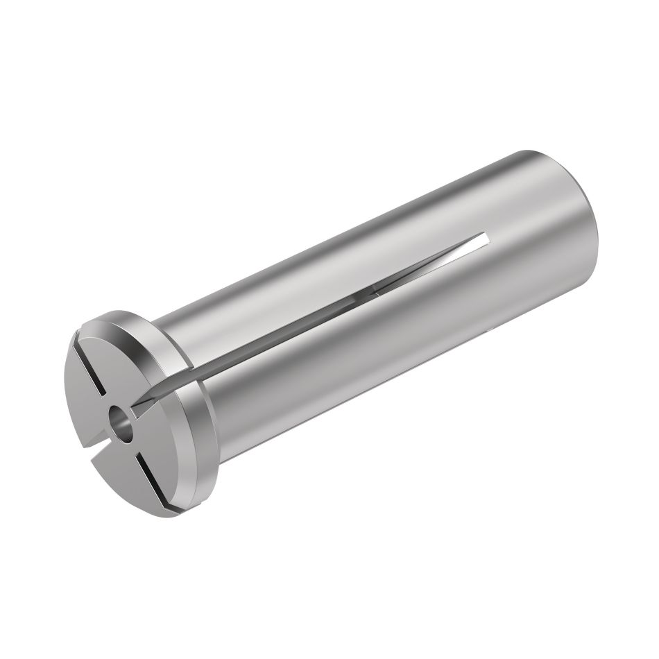

Hydraulic Sleeves • HC 12M - HC 32M • Metric with Metric Bores
Reducer Sleeves
Material Number3026651
ISO Catalog ID20MHC060MANSI Catalog ID20MHC060M
Metric with Metric Bores Tool Holders & Adapters - 3026651 - Kennametal
$176.85/each
Drawings for 3026651
[D1] Adapter / Shank / Bore Diameter6 mm
[D1] Adapter / Shank / Bore Diameter0.2362 in
[D] Adapter / Shank / Bore Diameter20 mm
[D] Adapter / Shank / Bore Diameter0.7874 in
[D2] Body Diameter 1 Workpiece Side 25 mm
[D2] Body Diameter 1 Workpiece Side 0.9843 in
[L1] Gage Length 1 4 mm
[L1] Gage Length 1 0.1575 in
[L9] Clamping Length 36 mm
[L9] Clamping Length 1.4173 in
[LS] Shank Length 50 mm
[LS] Shank Length 1.9685 in
  • One-piece design with slot configuration to seal coolant
  • Cutting tool must be cylindrical and have a through hole when using coolant
  • Sleeve must be inserted completely into the hydraulic chuck until shoulder mates against the hydraulic chuck front face
  • Cutting tools must be in full contact with the sleeve bore length (L9)
