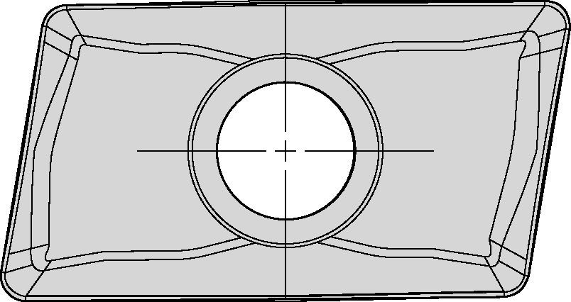

Insert for KDMR • JOMT-LF
Indexable Insert • JOMT-LF
Material Number3583700
ISO Catalog IDJOMT160408ERLFANSI Catalog IDJOMT160408ERLF
Insert for KDMR - JOMT-LF 3583700 - Kennametal
$25.13/each
Drawings for 3583700
GradeKC720M
[W] Insert Width 9.67 mm
[W] Insert Width 0.381 in
[S] Insert Thickness4.76 mm
[S] Insert Thickness0.1875 in
[L10] Insert Cutting Edge Length16.7 mm
[L10] Insert Cutting Edge Length0.657 in
[Rε] Corner Radius 0.8 mm
[Rε] Corner Radius 0.031 in
Average Chip Thickness [HM]0.06 mm
Average Chip Thickness [HM]0.0024 in
Cutting Edges per Insert2
KC720M
KC720M
Coated carbide grade with PVD TiAlN/TiN. KC720M is engineered to provide balanced wear and deformation resistance in combination with excellent breakage resistance.
  • Applicable as the side insert
