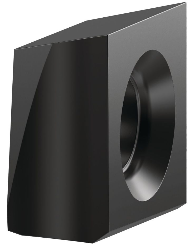

Inserts for Fix-Perfect™ 90° • SPHX1205-W • Finishing • GP
Indexable Inserts • SPHX1205... • Roughing • Finishing
Material Number1517764
ISO Catalog IDSPHX1205PCER-GP1WBANSI Catalog IDSPHX1205PCER-GP1WB
Fix-Perfect™ • Cast Iron Indexable Inserts • SPHX1205... • Finishing
$28.02/each
Drawings for 1517764
GradeKCK15
[L10] Insert Cutting Edge Length11 mm
[L10] Insert Cutting Edge Length0.4331 in
[S] Insert Thickness5.5 mm
[S] Insert Thickness0.2165 in
[BS] Corner Facet Length 2 mm
[BS] Corner Facet Length 0.0787 in
Average Chip Thickness [HM]0.02 mm
Average Chip Thickness [HM]0.0008 in
Cutting Edges per Insert1
KCK15
KCK15
