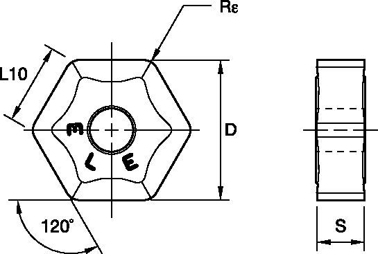

Solution Name: {{SolutionName}}Workpiece Materials
- For semi-finishing and light roughing operations.
Machine Side
Workpiece Side
KCK15
K Cast Iron
Insert Selection Guide
Material Group | Light Machining | General Purpose | Heavy Machining | |||
(Light geometry) | – | (Strong geometry) | ||||
wear resistance | toughness | |||||
Geometry | Grade | Geometry | Grade | Geometry | Grade | |
P5–P6 | – | – | – | – | – | – |
M3 | – | – | – | – | – | – |
K1–K2 | .E..LE | KCK15 | .S..GE | KCK15 | .S..GE | KCK15 |
K3 | .E..LE | KCK15 | .S..GE | KC514M | .S..GE | KCK15 |
