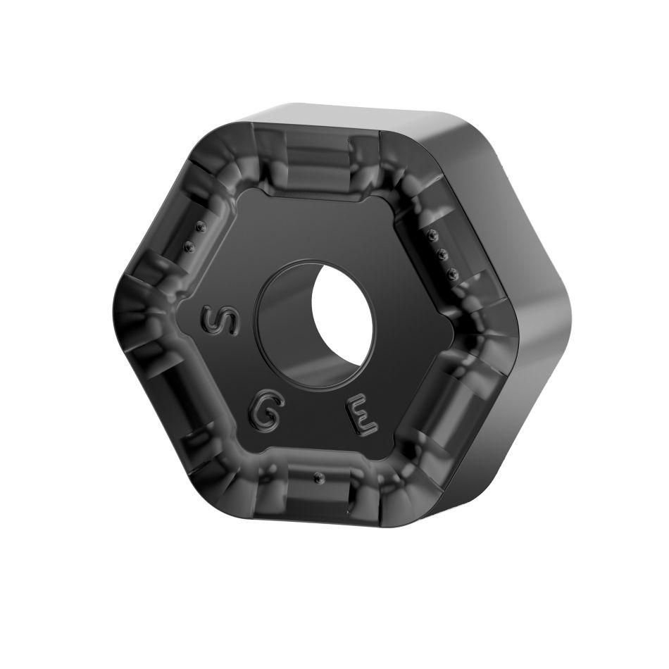

Inserts for HexaCut™ 45° • HNPX-S.GE
Indexable Inserts
Material Number5615680
ISO Catalog IDHNPX090520SNGEANSI Catalog IDHNPX5355SNGE
Inserts for HexaCut™ 45° - HNPX-S.GE 5615680 - Kennametal
$29.50/each
Drawings for 5615680
GradeKCK15
[D] Insert IC Size16.2 mm
[D] Insert IC Size0.638 in
[S] Insert Thickness5.56 mm
[S] Insert Thickness0.219 in
[L10] Insert Cutting Edge Length9.353 mm
[L10] Insert Cutting Edge Length0.3682 in
[Rε] Corner Radius 2 mm
[Rε] Corner Radius 0.079 in
Average Chip Thickness [HM]0.158 mm
Average Chip Thickness [HM]0.0062 in
Cutting Edges per Insert12
KCK15
KCK15
  • Heavy roughing geometry for severe machining conditions.
