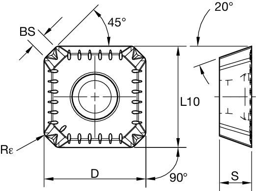

Material Number2390259
ISO Catalog IDSEKT1404AEENGP2
ANSI Catalog IDSEKT443AEEN7GP2
GradeKCK15
[D] Insert IC Size14 mm
[D] Insert IC Size0.551 in
[BS] Corner Facet Length 2.645 mm
[BS] Corner Facet Length 0.104 in
[L10] Insert Cutting Edge Length14 mm
[L10] Insert Cutting Edge Length0.5512 in
[Rε] Corner Radius 1 mm
[Rε] Corner Radius 0.039 in
[S] Insert Thickness4.763 mm
[S] Insert Thickness0.1875 in
Average Chip Thickness [HM]0.051 mm
Average Chip Thickness [HM]0.002 in
Cutting Edges per Insert4
