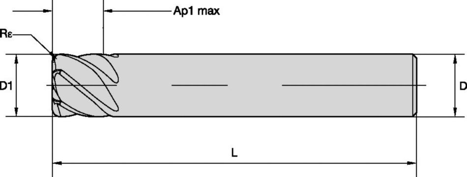

[Re] Corner Radius 0.794 mm
[Re] Corner Radius .0312 in
[Z] Number of Flutes 6
[D1] Effective Cutting Diameter 6.35 mm
[D1] Effective Cutting Diameter .25 in
[D] Adapter / Shank / Bore Diameter 6.35 mm
[D] Adapter / Shank / Bore Diameter .25 in
[AP1MAX] 1st Maximum Cutting Depth 4.763 mm
[AP1MAX] 1st Maximum Cutting Depth .1875 in
[L] Overall Length 50.8 mm
[L] Overall Length 2 in

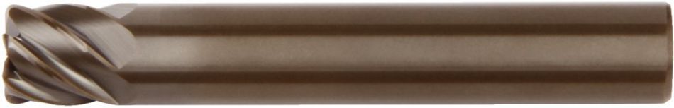

  • Face MillingFace Milling
  • Ramping: 2°Ramping: 2°
  • Tool Dimensions: Flute Configuration: 6Tool Dimensions: Flute Configuration: 6
  • Helix Angle: 40°Helix Angle: 40°
  • Inclined Square End MillInclined Square End Mill
S High-Temp Alloys
  • Full ceramic end mills offer highest productivity and tool life in roughing nickel-based high-temperature alloys.
  • Cutting speed up to 1000m/min.
  • Up to five times higher tool life than solid carbide end mills.
