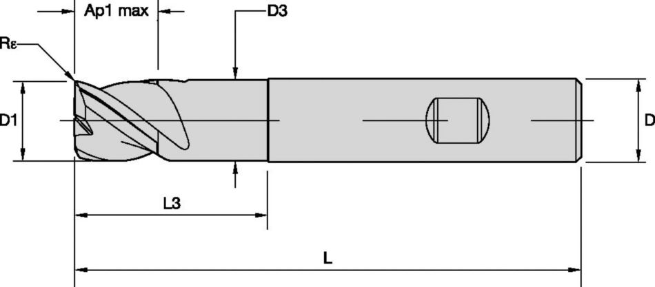

KenCut™ KS • F3AU • Radiused • 3 Flutes • Weldon® Shank • Metric
KenCut™ KS Solid Carbide End Mill for Keyway Milling
SAP Material Number 4061087
ISO Catalog Number F3AU0480BDK38
ANSI Catalog Number F3AU0480BDK38
Grade KC643M
Adapter Style Machine Side Weldon
[D1] Effective Cutting Diameter 4.8 mm
[D1] Effective Cutting Diameter .189 in
[D] Adapter / Shank / Bore Diameter 6 mm
[D] Adapter / Shank / Bore Diameter .2362 in
[D3] Neck Diameter 4.71 mm
[D3] Neck Diameter .1854 in
[AP1MAX] 1st Maximum Cutting Depth 6 mm
[AP1MAX] 1st Maximum Cutting Depth .2362 in
[L3] Usable Length 16 mm
[L3] Usable Length .6299 in
[L] Overall Length 54 mm
[L] Overall Length 2.126 in
[Re] Corner Radius 0.2 mm
[Re] Corner Radius .0079 in
[Z] Number of Flutes 3
  • Tool Dimensions: Flute Configuration: 3Tool Dimensions: Flute Configuration: 3
P Steel
M Stainless Steel
K Cast Iron
S High-Temp Alloys
H Hardened Materials
  • Keyway cutter for slot machining of shaft to hub connections.
  • For production of key slots according to ISO standards.
  • Roughing and finishing with one tool.
  • Center cutting for plunging and ramping operations.
  • Unequal flute spacing for chatter-free machining at highest feed rates.
