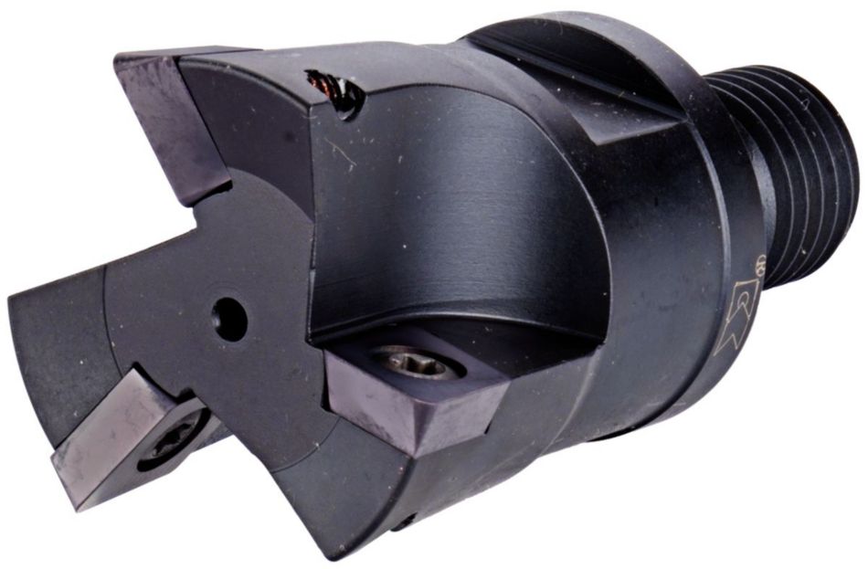

KMM • Screw-On End Mills • XDHX06... • Metric
Indexable Screw-On End Mills • XD_X06
Material Number1888448
ISO Catalog ID20Y03R030M10SXD06ANSI Catalog ID20Y03R030M10SXD06
KMM - Screw-On End Mills - XDHX06... - Metric 1888448 - Kennametal
$440.94/each
  • PocketingPocketing
Drawings for 1888448
[D1] Effective Cutting Diameter20 mm
[D1] Effective Cutting Diameter0.7874 in
[D] Adapter / Shank / Bore Diameter18 mm
[D] Adapter / Shank / Bore Diameter0.7087 in
[D2] Maximum Body Diameter17.6 mm
[D2] Maximum Body Diameter0.6929 in
[DPM] Pilot Diameter Machine Side10.5 mm
[DPM] Pilot Diameter Machine Side0.4134 in
[G3X] Connection Thread Size ExternalM10
[L2] Head Length 30 mm
[L2] Head Length 1.1811 in
[AP1MAX] 1st Maximum Cutting Depth1 mm
[AP1MAX] 1st Maximum Cutting Depth0.0394 in
Number of Inserts3
Weight Kilograms0.06
Gage InsertXD_X06021____
  • Rhombic-style inserts for reduced cutting forces.
  • Wide range of applications.
  • Improved surface quality.
