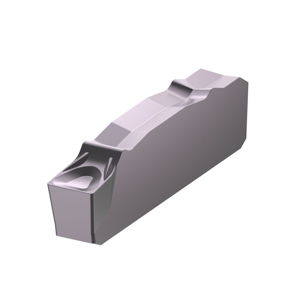

KNS® • Carbide Insert • XCP-SGP • Single Ended • Flat Bottom
Slot milling insert for flat-bottom machining in multiple materials.
Material Number5615007
ISO Catalog IDXCP42S500F030SGPANSI Catalog IDXCP42S500F030SGP

GradeKCU25
Insert Size42
[W] Cutting Width 5.01 mm
[W] Cutting Width 0.197 in
[LI] Insert Length 18 mm
[LI] Insert Length 0.709 in
[RR] Corner Radius0.3 mm
[RR] Corner Radius0.012 in
[RL] Corner Radius 0.3 mm
[RL] Corner Radius 0.012 in
[S] Insert Thickness4.65 mm
[S] Insert Thickness0.183 in
Average Chip Thickness [HM]0.04 mm
Average Chip Thickness [HM]0.0016 in
Cutting Edges per Insert1
KCU25
KCU25
Composition: An advanced PVD grade with hard AlTiN coating and fine-grain unalloyed substrate. The new and improved coating improves edge stability with wide range speed and feed capabilities.
Application: The KCU25™ grade is ideal for general machining of most steels, stainless steels, high-temp alloys, titanium, irons, and non-ferrous materials in a wide range of speeds and feeds with improved edge toughness for interrupted cuts and high feed rates.
  • From light to heavy machining, the positive SGP chipbreaker geometry ensures smooth cutting action, and efficient chip evacuation.
  • The Double-V Design of the insert and the insert pocket securely holds the insert in place, minimises radial runout, providing high slot width accuracy and high repeatability.
