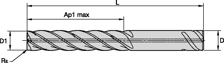

Drawings for 6974940
Material Number6974940
ISO Catalog IDKOR5RA1600L080SLR050IM
ANSI Catalog IDKOR5RA1600L080SLR050IM
GradeK600
Adapter Style Machine SideSAFE-LOCK
[D1] Effective Cutting Diameter16 mm
[D1] Effective Cutting Diameter0.6299 in
[D] Adapter / Shank / Bore Diameter16 mm
[D] Adapter / Shank / Bore Diameter0.6299 in
[AP1MAX] 1st Maximum Cutting Depth80 mm
[AP1MAX] 1st Maximum Cutting Depth3.1496 in
[L] Overall Length 141 mm
[L] Overall Length 5.5512 in
[Re] Corner Radius 0.5 mm
[Re] Corner Radius 0.02 in
[Z] Number of Flutes5
