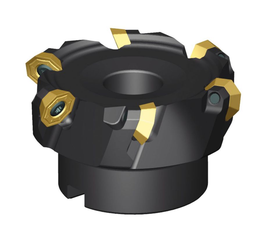

  • Face MillingFace Milling
Drawings for 2487015
Material Number2487015
ISO Catalog ID50A06RS45OF06A
ANSI Catalog ID50A06RS45OF06A
[D1] Effective Cutting Diameter50 mm
[D1] Effective Cutting Diameter1.9685 in
[D1MAX] Maximum Cutting Diameter58.9 mm
[D1MAX] Maximum Cutting Diameter2.3189 in
[D] Adapter / Shank / Bore Diameter22 mm
[D] Adapter / Shank / Bore Diameter0.8661 in
[D6] Hub Diameter 42 mm
[D6] Hub Diameter 1.654 in
[L] Overall Length 43 mm
[L] Overall Length 1.6929 in
[AP1MAX] 1st Maximum Cutting Depth3.5 mm
[AP1MAX] 1st Maximum Cutting Depth0.138 in
Number of Inserts6
Maximum Ramping Angle5
Weight Kilograms0.36
Max RPM12730
  • Soft cutting action resulting in low cutting forces.
  • "X" in the catalog number stands for improved finishing capabilities through a reduced axial cutting angle of 18°.
  • Internal coolant supply.
