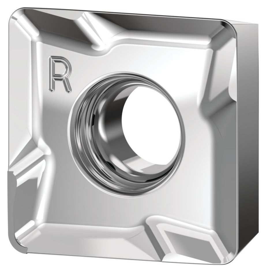

KSSM™ 10 • Carbide Insert • SPCT-LE • Light Machining of Aluminum
Shoulder and slot milling insert with four cutting edges, precision ground.
Material Number2383603
ISO Catalog IDSPCT10T3PPFRLEANSI Catalog IDSPCT3125PPFR8LE
Inserts for KSSM 0° - IC 10mm - SP.T10T3 - SPCT-LE - Inch 2383603 - Kennametal
$26.45/each
Drawings for 2383603
GradeKC410M
[D] Insert IC Size10 mm
[D] Insert IC Size0.394 in
[D1] Insert Hole Size 3.4 mm
[D1] Insert Hole Size 0.134 in
[S] Insert Thickness3.969 mm
[S] Insert Thickness0.1562 in
[L10] Insert Cutting Edge Length10 mm
[L10] Insert Cutting Edge Length0.3937 in
[BS] Corner Facet Length 2.7 mm
[BS] Corner Facet Length 0.106 in
[Rε] Corner Radius 0.8 mm
[Rε] Corner Radius 0.031 in
Average Chip Thickness [HM]0.02 mm
Average Chip Thickness [HM]0.0008 in
Cutting Edges per Insert4
KC410M
KC410M
PVD, TiB2 coating on grade KC410M is extremely hard and provides very good wear characteristics at higher cutting speeds. KC410M resists built-up edge, reduces burrs, and generates excellent surface finishes. The grade is best suited for aluminum with <10% silicon and other non-ferrous materials.
  • Single sided insert for lower power requirements.
