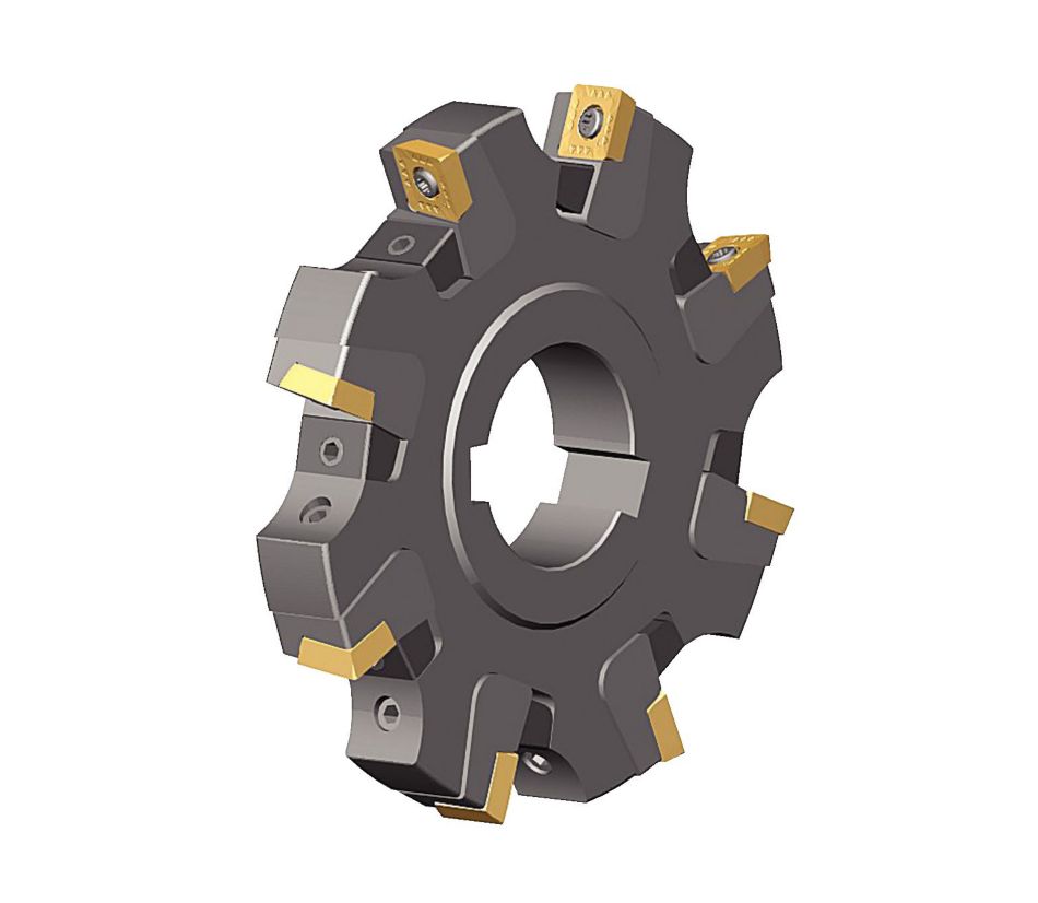

KSSM™ Slotting Cutters - IC 10 - Adjustable (Arbor Mount - Half-Side Cutting - Right Hand 14 mm ) • Metric
Type A, Arbor Mount • 10mm IC Inserts
Material Number2443456
ISO Catalog ID160H10RK90SP10N14KANSI Catalog ID160H10RK90SP10N14K
KSSM™ Slotting Cutters - IC 10 - Adjustable (Arbor Mount - Half-Side Cutting - Right Hand 14 mm ) - Metric 2443456 - Kennametal
$2,429.57/each
Drawings for 2443456
[D1] Effective Cutting Diameter160 mm
[D1] Effective Cutting Diameter6.299 in
[D] Adapter / Shank / Bore Diameter1.5748 in
[D6] Hub Diameter 54.75 mm
[D6] Hub Diameter 2.155 in
[CDX] Radial Maximum Depth of Cut51.87 mm
[CDX] Radial Maximum Depth of Cut2.042 in
[L1] Gage Length13.85 mm
[L1] Gage Length0.5482 in
[THUB] Hub Thickness 13.85 mm
[THUB] Hub Thickness 0.545 in
[V] Adjustment Range 1 mm
[V] Adjustment Range0.0394 in
[AP1MAX] 1st Maximum Cutting Depth9.119 mm
[AP1MAX] 1st Maximum Cutting Depth0.359 in
Number of Inserts10
Number of Effective Cutting Edges on Face10
Max RPM13650
Weight Kilograms1.5
  • Rapid adjustment and setting via unique cam adjustment mechanism.
  • Large selection of insert geometries and grades to cut most workpiece materials.
  • Four insert cutting edges.
  • Wide choice of insert radii.
  • Two keyways for staggered mounting.
  • Wiper insert facets for superior surface finishes.
