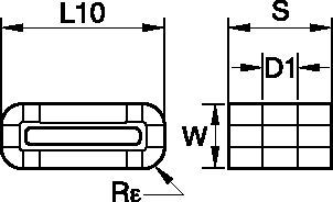

    Drawings for 3594302
    Material Number3594302
    ISO Catalog IDLNUX191940RRSM
    ANSI Catalog IDLNUX191940RRSM
    GradeKC9110
    [W] Insert Width 10 mm
    [W] Insert Width 0.394 in
    [L10] Insert Cutting Edge Length19 mm
    [L10] Insert Cutting Edge Length0.748 in
    [S] Insert Thickness19.05 mm
    [S] Insert Thickness0.75 in
    [Rε] Corner Radius 4 mm
    [Rε] Corner Radius 0.157 in
    [D1] Insert Hole Size 6.35 mm
    [D1] Insert Hole Size 0.25 in
    KC9110
    KC9110
