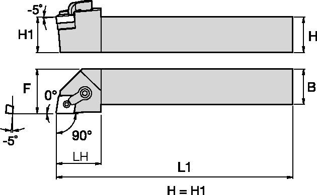

Drawings for 1096111
Material Number1096111
ISO Catalog IDMCGNR164C
ANSI Catalog IDMCGNR164C
[H] Shank Height 25.4 mm
[H] Shank Height 1 in
[B] Shank Width 25.4 mm
[B] Shank Width 1 in
[F] F Dimension 31.75 mm
[F] F Dimension 1.25 in
[L1] Tool Length 127 mm
[L1] Tool Length 5 in
[LH] Head Length 31.75 mm
[LH] Head Length 1.25 in
Gage InsertCN..432
Lock Pin ID Drive Size3/32
Clamp Screw ID Drive Size1/8
