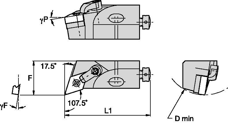

Drawings for 3330277
Material Number3330277
ISO Catalog IDMDQNR16CA15
ANSI Catalog IDMDQNR16CA4
[DM] Minimum Bore Diameter 60 mm
[DM] Minimum Bore Diameter 2.3622 in
[F] F Dimension 25 mm
[F] F Dimension 0.9843 in
[L1] Tool Length 63 mm
[L1] Tool Length 2.4803 in
[GAAP] Axial Rake Angle6
