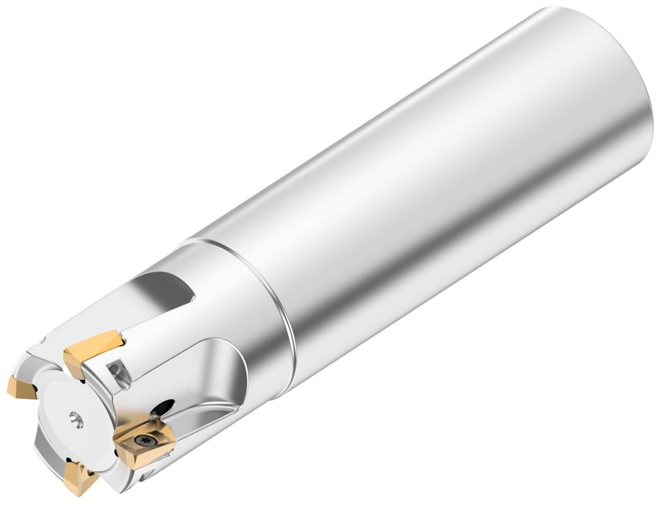

Mill 1-10™ • End Mill • Cylindrical Shank • Metric
Material Number3744538
ISO Catalog ID12A01R020A16ED10ANSI Catalog ID12A01R020A16ED10
- P Steel
- M Stainless Steel
- K Cast Iron
- N Non-Ferrous
- S High-Temp Alloys
- H Hardened Materials
- .caption
Face Milling
Helical Milling
Ramping: Blank
Slotting: Square End
Shank - Cylindrical Plain
Milling - Through Coolant
Pocketing
- Overview
- Application Data
- Downloads
- Spare Parts
| Material Number | 3744538 |
| ISO Catalog ID | 12A01R020A16ED10 |
| ANSI Catalog ID | 12A01R020A16ED10 |
| [D1] Effective Cutting Diameter | 12 mm |
| [D1] Effective Cutting Diameter | 0.472 in |
| [D] Adapter / Shank / Bore Diameter | 16 mm |
| [D] Adapter / Shank / Bore Diameter | 0.6299 in |
| [L] Overall Length | 90 mm |
| [L] Overall Length | 3.543 in |
| [L2] Head Length | 20 mm |
| [L2] Head Length | 0.787 in |
| [AP1MAX] 1st Maximum Cutting Depth | 10 mm |
| [AP1MAX] 1st Maximum Cutting Depth | 0.404 in |
| Number of Inserts | 1 |
| Maximum Ramping Angle | 11.5 |
| Weight Kilograms | 0.12 |
| Max RPM | 57800 |
