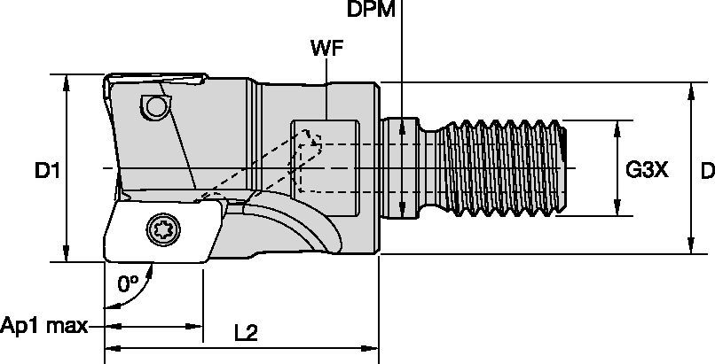

Drawings for 3742513
Material Number3742513
ISO Catalog IDM1D100E1003CM12
ANSI Catalog IDM1D100E1003CM12
[D1] Effective Cutting Diameter25.4 mm
[D1] Effective Cutting Diameter1 in
[D] Adapter / Shank / Bore Diameter21 mm
[D] Adapter / Shank / Bore Diameter0.8268 in
[DPM] Pilot Diameter Machine Side12.5 mm
[DPM] Pilot Diameter Machine Side0.4921 in
[G3X] Connection Thread Size ExternalM12
[L2] Head Length 31.75 mm
[L2] Head Length 1.25 in
[WF] Width of Flat 16.95 mm
[WF] Width of Flat 0.6673 in
[AP1MAX] 1st Maximum Cutting Depth10.03 mm
[AP1MAX] 1st Maximum Cutting Depth0.3949 in
Number of Inserts3
[Z] Number of Flutes3
Maximum Ramping Angle4
Weight Pounds0.19
Max RPM39700
