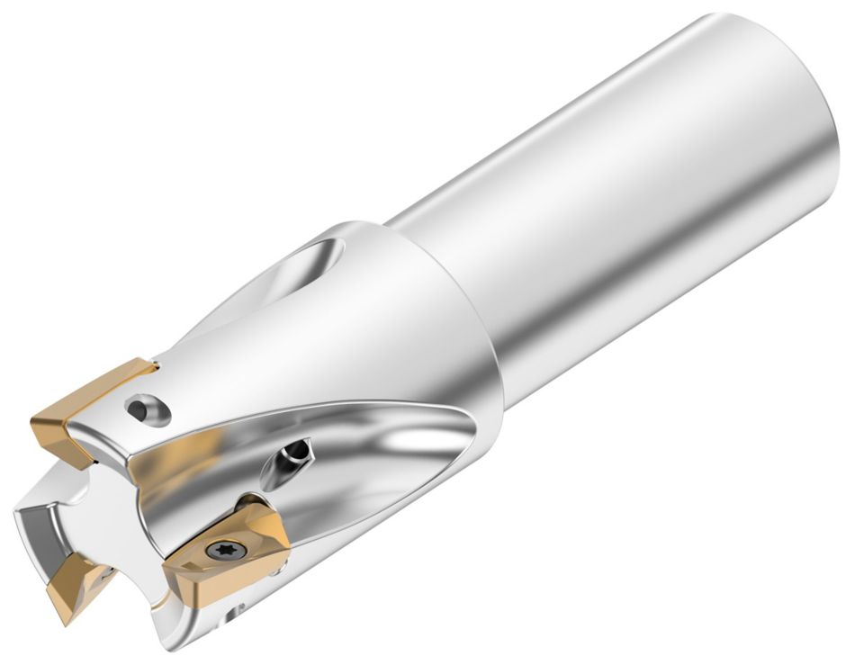

Material Number | 2624187 |
ISO Catalog ID | M1D075E1402C075L650 |
ANSI Catalog ID | M1D075E1402C075L650 |
[D1] Effective Cutting Diameter | 19.05 mm |
[D1] Effective Cutting Diameter | .75 in |
[D] Adapter / Shank / Bore Diameter | 19.05 mm |
[D] Adapter / Shank / Bore Diameter | .75 in |
[L] Overall Length | 165.1 mm |
[L] Overall Length | 6.5 in |
[L2] Head Length | 44.45 mm |
[L2] Head Length | 1.75 in |
[AP1MAX] 1st Maximum Cutting Depth | 14.6 mm |
[AP1MAX] 1st Maximum Cutting Depth | .57 in |
Number of Inserts | 2 |
Maximum Ramping Angle | 18.5 |
Weight Pounds | 0.65 |
Max RPM | 49600 |
- Steel
- Stainless Steel
- Cast Iron
- Non-Ferrous
- High-Temp Alloys
- Hardened Materials
- Face Milling
- Helical Milling
- Ramping: Blank
- Slotting: Square End
- Side Milling/Shoulder Milling: Square End
- Shank - Cylindrical Plain
- Milling - Through Coolant
- Pocketing
- Internal coolant supply.
- For ramping, slotting, plunging, facing, and true 90° walls.
Insert Selection Guide
