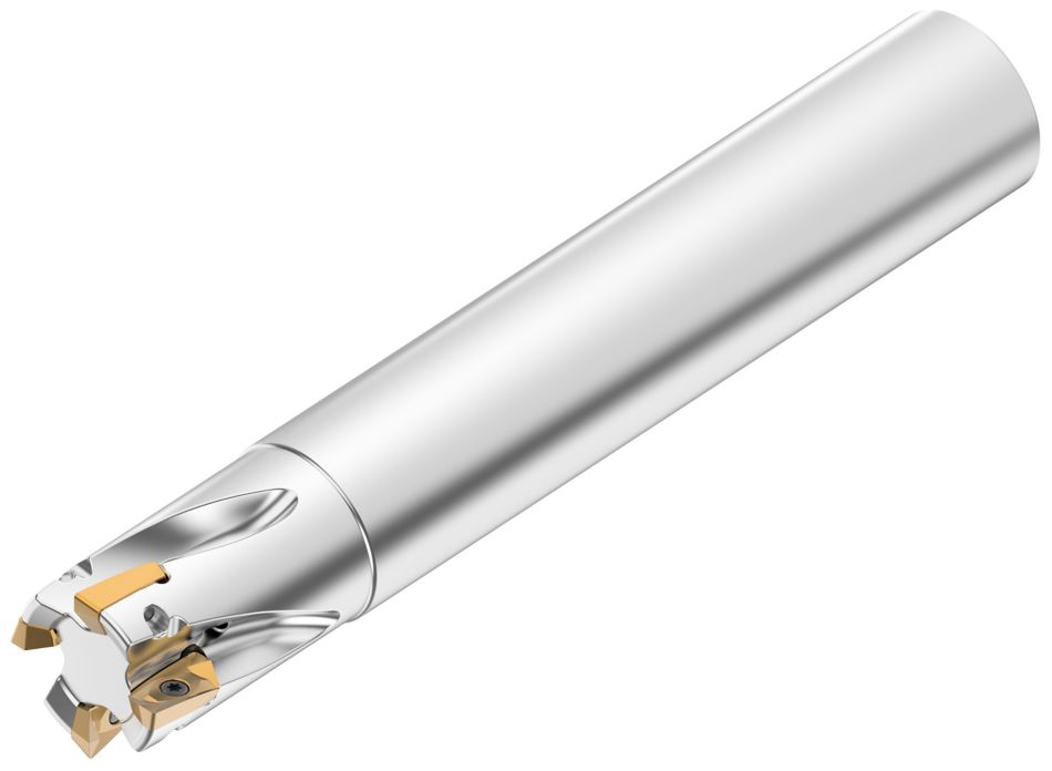

Mill 1-14™ • End Mill • Long • Cylindrical Shank • Metric
Material Number2968366
ISO Catalog ID40A05R050A32SED14-200ANSI Catalog IDM1D040ME1405C032L050-200

Material Number | 2968366 |
ISO Catalog ID | 40A05R050A32SED14-200 |
ANSI Catalog ID | M1D040ME1405C032L050-200 |
[D1] Effective Cutting Diameter | 40 mm |
[D1] Effective Cutting Diameter | 1.574 in |
[D] Adapter / Shank / Bore Diameter | 32 mm |
[D] Adapter / Shank / Bore Diameter | 1.259 in |
[L] Overall Length | 200 mm |
[L] Overall Length | 7.874 in |
[L2] Head Length | 50 mm |
[L2] Head Length | 1.968 in |
[AP1MAX] 1st Maximum Cutting Depth | 14.4 mm |
[AP1MAX] 1st Maximum Cutting Depth | .5669 in |
Number of Inserts | 5 |
Maximum Ramping Angle | 4.8 |
Weight Kilograms | 1.25 |
Max RPM | 28700 |

- Internal coolant supply
- For ramping, slotting, plunging, facing and true 90° walls
