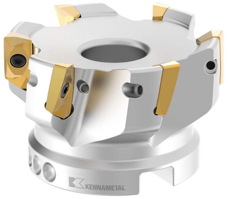

Mill 1-14™ • Shell Mill • Metric
Material Number2623942
ISO Catalog ID63A06RS90ED14DANSI Catalog IDM1D063ME1406S022L040
- P Steel
- M Stainless Steel
- K Cast Iron
- N Non-Ferrous
- S High-Temp Alloys
- H Hardened Materials
- .caption
Face Milling
Helical Milling
Ramping: Blank
Slotting: Square End
Milling - Through Coolant
Milling - Side and Face
Pocketing
- Overview
- Application Data
- Downloads
- Spare Parts
- Reviews
- Q&A
Material Number | 2623942 |
ISO Catalog ID | 63A06RS90ED14D |
ANSI Catalog ID | M1D063ME1406S022L040 |
[D1] Effective Cutting Diameter | 63 mm |
[D1] Effective Cutting Diameter | 2.48 in |
[D] Adapter / Shank / Bore Diameter | 22 mm |
[D] Adapter / Shank / Bore Diameter | 0.87 in |
[D6] Hub Diameter | 50 mm |
[D6] Hub Diameter | 1.969 in |
[L] Overall Length | 40 mm |
[L] Overall Length | 1.575 in |
[AP1MAX] 1st Maximum Cutting Depth | 14 mm |
[AP1MAX] 1st Maximum Cutting Depth | 0.55 in |
Number of Inserts | 6 |
Maximum Ramping Angle | 2.5 |
Weight Kilograms | 0.49 |
Max RPM | 21800 |
