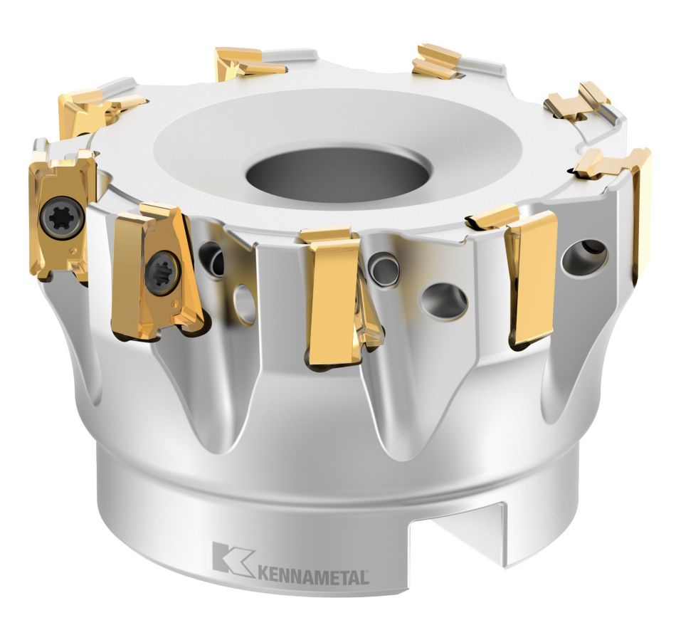

Mill 4-11™ • Shell Mill • Inch
Material Number6139923
ISO Catalog IDM4D250L1107S100L157ANSI Catalog IDM4D250L1107S100L157
- P Steel
- M Stainless Steel
- K Cast Iron
- N Non-Ferrous
- S High-Temp Alloys
- H Hardened Materials
- .caption
Face Milling
Slotting: Square End
Milling - Through Coolant
Milling - Side and Face
- Overview
- Application Data
- Downloads
- Spare Parts
| Material Number | 6139923 |
| ISO Catalog ID | M4D250L1107S100L157 |
| ANSI Catalog ID | M4D250L1107S100L157 |
| [D1] Effective Cutting Diameter | 63.5 mm |
| [D1] Effective Cutting Diameter | 2.5 in |
| [D] Adapter / Shank / Bore Diameter | 25.4 mm |
| [D] Adapter / Shank / Bore Diameter | 1 in |
| [D6] Hub Diameter | 55.63 mm |
| [D6] Hub Diameter | 2.19 in |
| [L] Overall Length | 40.005 mm |
| [L] Overall Length | 1.575 in |
| [AP1MAX] 1st Maximum Cutting Depth | 11 mm |
| [AP1MAX] 1st Maximum Cutting Depth | 0.433 in |
| Number of Inserts | 7 |
| Weight Pounds | 1.39 |
| Max RPM | 19500 |

- True 90° capabilities with a stepless solution when using multiple steps
- Superior wall and surface finish capabilities
- Internal coolant supply
