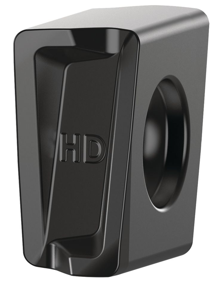

Mill 4-12KT™ • Carbide Insert • LNGQ-HD • Heavy Machining
Shoulder milling insert with four cutting edges per insert, precision ground
Material Number7009761
ISO Catalog IDLNGQ120608ERHDKT4ANSI Catalog IDLNGQ120608ERHDKT4
Mill 4™-12<sup>KT</sup> - Carbide Insert - LNGQ-HD - Heavy Machining 7009761 - Kennametal
Mill 4™-12<sup>KT</sup> - Carbide Insert - LNGQ-HD - Heavy Machining 7009761 - Kennametal+0
$38.39/each
Drawings for 7009761
GradeKCPK30
[LI] Insert Length 13 mm
[LI] Insert Length 0.5118 in
[S] Insert Thickness6.35 mm
[S] Insert Thickness0.25 in
[W] Insert Width 13.147 mm
[W] Insert Width 0.5176 in
[Rε] Corner Radius 0.8 mm
[Rε] Corner Radius 0.031 in
Average Chip Thickness [HM]0.05 mm
Average Chip Thickness [HM]0.002 in
Cutting Edges per Insert4
KCPK30
KCPK30
Coated carbide grade with CVD multilayer (TiN/TiCN/Al2O3) and advanced Beyond™ post-coat treatment. Substrate is very tough. KCPK30 has a wide application area in general and roughing milling of steels and cast irons. Performs best dry, but can also be used wet.
  • Precision ground insert for best surface finish.
  • Advanced insert/pocket interface ensures stability and consistent performance in difficult applications.
  • Up to 15% lower power consumption.
  • Easy insert indexing through screw clamping.
