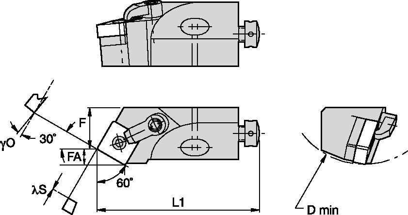

Drawings for 2074904
Material Number2074904
ISO Catalog IDMSTNR12CA12
ANSI Catalog IDMSTNR12CA4
[DM] Minimum Bore Diameter 50 mm
[DM] Minimum Bore Diameter 1.9685 in
[F] F Dimension 13 mm
[F] F Dimension 0.5118 in
[FA] F A Dimension 5.86 mm
[FA] F A Dimension 0.2307 in
[L1] Tool Length 55 mm
[L1] Tool Length 2.1654 in
Inclination Angle11
[GAAO] Orthogonal Rake Angle0
Gage InsertSN..120408/SN..432
