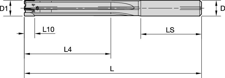

Drawings for 6761045
Material Number6761045
ISO Catalog IDR215A05000H6SF
ANSI Catalog IDR215A05000H6SF
GradeKD1415
[D1] Reamer Diameter Minimum12.7 mm
[D1] Reamer Diameter Minimum0.5 in
[D] Adapter / Shank / Bore Diameter12.7 mm
[D] Adapter / Shank / Bore Diameter0.5 in
[L] Overall Length 124 mm
[L] Overall Length 4.8819 in
[L4] Maximum Reaming Depth 60 mm
[L4] Maximum Reaming Depth 2.3585 in
[L10] Cutting Edge Length7.109 mm
[L10] Cutting Edge Length0.2799 in
[LS] Shank Length 45.5 mm
[LS] Shank Length 1.7913 in
[Z] Number of Flutes4
