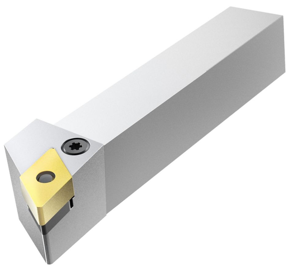

PDJN 93°
Kenloc™ Inserts
Material Number1244658
ISO Catalog IDPDJNL2020K11ANSI Catalog IDPDJNL2020K11
Kenlever™ PDJNL2020K11 Toolholder 1244658 - Kennametal
$141.27/each
  • C CFRP Materials
  • TurningTurning
  • ProfilingProfiling
Drawings for 1244658
[H] Shank Height 20 mm
[H] Shank Height 0.7874 in
[B] Shank Width 20 mm
[B] Shank Width 0.7874 in
[F] F Dimension 25 mm
[F] F Dimension 0.9843 in
[L1] Tool Length 125 mm
[L1] Tool Length 4.921 in
[LH] Head Length 30 mm
[LH] Head Length 1.18 in
Inclination Angle7
Gage InsertDN..110408
Clamp Screw ID Drive Size10 IP
