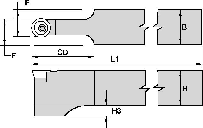

Drawings for 1095808
Material Number1095808
ISO Catalog IDPROON246
ANSI Catalog IDPROON246
[H] Shank Height 38.1 mm
[H] Shank Height 1.5 in
[B] Shank Width 38.1 mm
[B] Shank Width 1.5 in
[F] F Dimension 28.575 mm
[F] F Dimension 1.125 in
[L1] Tool Length 203.2 mm
[L1] Tool Length 8 in
[CD] Cutting Depth 60.3 mm
[CD] Cutting Depth 2.374 in
Gage InsertRC..64
Lock Pin ID Drive Size1/8
