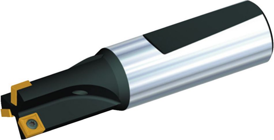

  • CTR Counterboring Tools are designed for high-production screw head counterbores and similar counterboring operations.
  • Extremely unequal insert positioning and flutes.
  • S2 S inserts reduce additional drill operations to achieve a precise 90° bottom.
  • Counterboring tool shipped with insert screws and Torx wrench.
