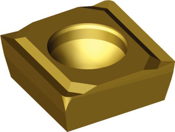

SPHX-R20
CTR Drilling Inserts
Material Number5533643
ISO Catalog IDSPHX090308R20ANSI Catalog IDSPHX090308R20
SPHX-R20 Holemaking - 5533643 - Kennametal
$27.16/each
Drawings for 5533643
GradeKCU25
[D] Insert IC Size9.525 mm
[D] Insert IC Size0.375 in
[D1] Insert Hole Size 3.5 mm
[D1] Insert Hole Size 0.1378 in
[S] Insert Thickness3.18 mm
[S] Insert Thickness0.1252 in
[Rε] Corner Radius 0.8 mm
[Rε] Corner Radius 0.0312 in
[GAA] Insert Rake Angle12
[Clearance Angle Major7
Clearning Angle Minor7
KCU25
KCU25
Composition: An advanced PVD grade with hard AlTiN coating and fine-grain unalloyed substrate. The new and improved coating improves edge stability with wide range speed and feed capabilities.
Application: The KCU25™ grade is ideal for general machining of most steels, stainless steels, high-temp alloys, titanium, irons, and non-ferrous materials in a wide range of speeds and feeds with improved edge toughness for interrupted cuts and high feed rates.
  • Double-sided insert style.
