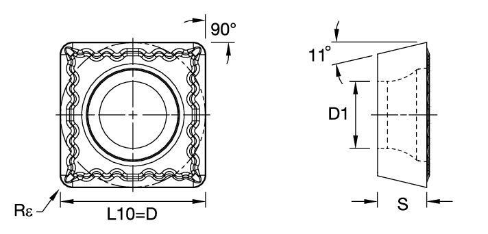

Drawings for 7093166
Material Number7093166
ISO Catalog IDSPMT09T308UF
ANSI Catalog IDSPMT3252UF
GradeKCU10B
[D] Insert IC Size9.525 mm
[D] Insert IC Size0.375 in
[L10] Insert Cutting Edge Length9.525 mm
[L10] Insert Cutting Edge Length0.375 in
[S] Insert Thickness3.97 mm
[S] Insert Thickness0.1563 in
[Rε] Corner Radius 0.8 mm
[Rε] Corner Radius 0.031 in
[D1] Insert Hole Size 4.4 mm
[D1] Insert Hole Size 0.1732 in
