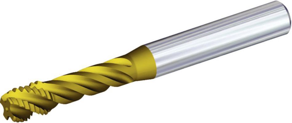

T331 • Metric • Form C Semi-Bottoming Chamfer • Through Coolant
Beyond™ Solid Carbide Spiral-Flute Taps • Blind Holes
Material Number3483059
ISO Catalog IDT331M100X150R6HXANSI Catalog IDT331M100X150R6HX

  • Class of Fit: 6HXClass of Fit: 6HX
  • Chamfer Form C (2–3)Chamfer Form C (2–3)
  • Through Coolant: Axial: TappingThrough Coolant: Axial: Tapping
  • HMHM
  • Manufacturer’s Specs: MFManufacturer’s Specs: MF
  • Tapping Helix Angle: 45°Tapping Helix Angle: 45°
GradeKC7542
[D1-TDZ] Thread Diameter SizeM10 X 1.5
[L] Overall Length 90 mm
[L] Overall Length 3.5433 in
[L3] Thread Length 12 mm
[L3] Thread Length 0.4724 in
[L2] Useable Length 40 mm
[L2] Useable Length 1.5748 in
[D] Adapter / Shank / Bore Diameter10 mm
[D] Adapter / Shank / Bore Diameter0.3937 in
[Z] Number of Flutes4
Thread Tolerance Class ISO6HX-I
  • HMHM
KC7542
KC7542
Coated carbide, PVD — multilayer coating with TiAlN and TiN over a high-strength carbide substrate specifically designed for tap application. Use in steel up to 32 HRC and cast iron at 4x faster speeds than HSS-E-PM taps.
  • KC7542 TiAlN + TiN for steel.
