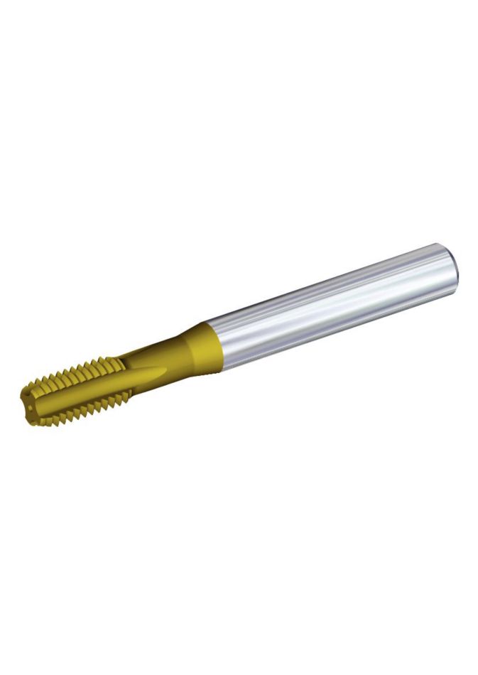

T351 • Metric • Form E Bottoming Chamfer • Through Coolant M6 and Larger
Beyond™ Solid Carbide Straight-Flute Taps • Blind Holes
Material Number3632195
ISO Catalog IDT351M200X250R6HXANSI Catalog IDT351M200X250R6HX
T351 Form E-Btm-Cool M6+ Threading - 3632195 - Kennametal

Drawings for 3632195
GradeKCK17
[D1-TDZ] Thread Diameter SizeM20 X 2.5
[L] Overall Length 140 mm
[L] Overall Length 5.5118 in
[L3] Thread Length 30 mm
[L3] Thread Length 1.1811 in
[L2] Useable Length 66 mm
[L2] Useable Length 2.5984 in
[D] Adapter / Shank / Bore Diameter18 mm
[D] Adapter / Shank / Bore Diameter0.7087 in
[Z] Number of Flutes5
Thread Tolerance Class ISO6HX-I
  • Class of Fit: 6HXClass of Fit: 6HX
  • Chamfer Form E (1.5–2)Chamfer Form E (1.5–2)
  • Through Coolant: Axial: TappingThrough Coolant: Axial: Tapping
  • HMHM
  • Manufacturer’s Specs: MFManufacturer’s Specs: MF
  • Tapping Helix Angle: 0°Tapping Helix Angle: 0°
KCK17
KCK17
Multilayer PVD AlCrN-coated fine-grain carbide. Newly-developed unique coating. Extraordinary wear resistance when tapping cast iron. High-temperature hardness enables long life at up to 4x faster speed than HSS-E-PM taps.
