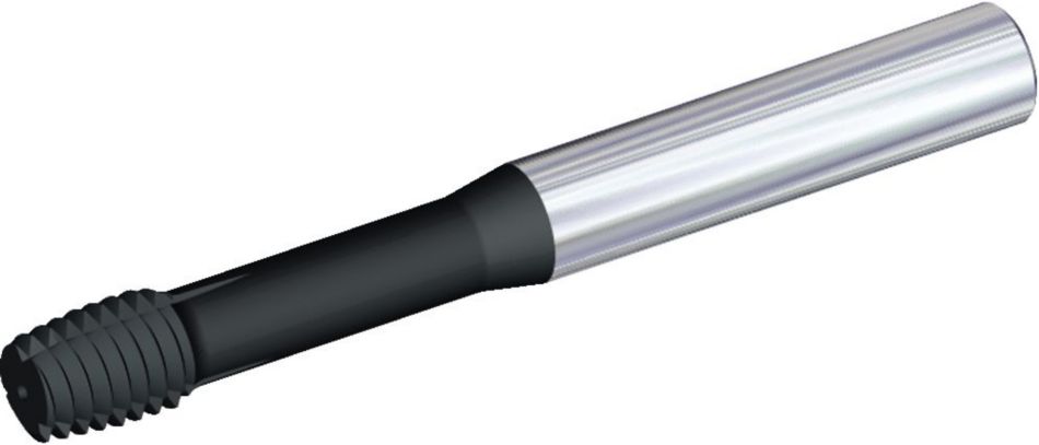

T491 • Form E Bottoming Entry Taper • Through Coolant M6 and Larger • Metric • For Aluminum
Beyond™ Solid Carbide Forming Taps • Blind Holes
Material Number5551083
ISO Catalog IDT491M060X100R6HXANSI Catalog IDT491M060X100R6HX
T491 Metric Threading - 5551083 - Kennametal
$217.73/each
  • Class of Fit: 6HXClass of Fit: 6HX
  • Chamfer Form E (1.5–2)Chamfer Form E (1.5–2)
  • Through Coolant: Axial: TappingThrough Coolant: Axial: Tapping
  • HMHM
Drawings for 5551083
GradeKCN14
[D1-TDZ] Thread Diameter SizeM6 X 1
[L] Overall Length 70 mm
[L] Overall Length 2.76 in
[L3] Thread Length 8 mm
[L3] Thread Length 0.31 in
[L2] Useable Length 24 mm
[L2] Useable Length 0.94 in
[D] Adapter / Shank / Bore Diameter6 mm
[D] Adapter / Shank / Bore Diameter0.2362 in
Number of Lube Grooves2
Thread Tolerance Class ISO6HX-I
  • HMHM
KCN14
KCN14
Coated carbide, PVD — two-layer coating over fine-grain carbide. Coating consists of low-friction CrC/C over wear-resistant TiN. CrC/C resists galling of non-ferrous materials to the tap. Provides superior performance for tapping cast aluminum and other non-ferrous materials.
  • KCN14 TiN + CrC/C for aluminum.
