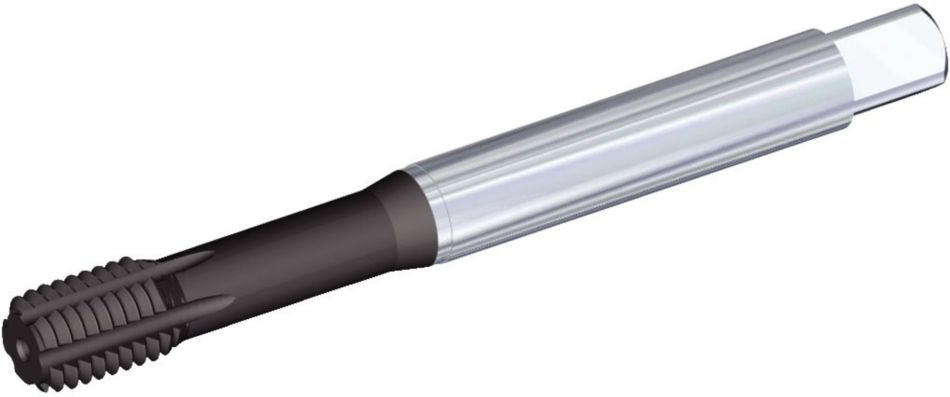

T623 • Metric DIN 2174 • Form C Semi-Bottoming Entry Taper
Beyond™ Forming Taps HSS-E-PM • Blind Holes
SAP Material Number 4159847
ISO Catalog Number T623MF100X100R6HX-D74
ANSI Catalog Number T623MF100X100R6HX-D74
Grade KSP21
[D1-TDZ] Thread Diameter Size M10 X 1
[L] Overall Length 90 mm
[L] Overall Length 3.543 in
[L3] Thread Length 10 mm
[L3] Thread Length .394 in
[L2] Useable Length 35 mm
[L2] Useable Length 1.378 in
[D] Adapter / Shank / Bore Diameter 10 mm
[D] Adapter / Shank / Bore Diameter .3937 in
[Z] Number of Flutes 5
Number of Lube Grooves 5
Dimension Standard DIN 2174
Thread Tolerance Class ISO 6HX-I
  • Class of Fit: 6HXClass of Fit: 6HX
  • Chamfer Form C (2–3)Chamfer Form C (2–3)
  • HSS-E-PMHSS-E-PM
  • Through Coolant: Axial: TappingThrough Coolant: Axial: Tapping
  • Manufacturer’s Specs: MFManufacturer’s Specs: MF
  • DIN number 2174DIN number 2174
P Steel
  • KSP21 TiN for tapping steel.
  • KSN28 DLC for tapping aluminum.
