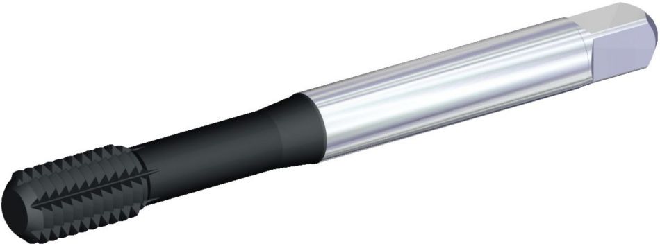

T626 • DIN Length ANSI Shank • Form E Bottoming Entry Taper • Metric
Beyond™ Forming Taps HSS-E-PM • Blind Holes
Material Number5946080
ISO Catalog IDT626M050X080RD7-DAANSI Catalog IDT626M050X080RD7-DA
T626 Forming Tap MM Threading - 5946080 - Kennametal
$64.03/each
  • Chamfer Form E (1.5–2)Chamfer Form E (1.5–2)
  • HSS-E-PMHSS-E-PM
  • Manufacturer’s Specs: MFManufacturer’s Specs: MF
  • DIN Number ANSIDIN Number ANSI
Drawings for 5946080
GradeKSP27
[D1-TDZ] Thread Diameter SizeM5 X 0.8
[L] Overall Length 70 mm
[L] Overall Length 2.76 in
[L3] Thread Length 10 mm
[L3] Thread Length 0.39 in
[L2] Useable Length 25 mm
[L2] Useable Length 0.98 in
[D] Adapter / Shank / Bore Diameter4.928 mm
[D] Adapter / Shank / Bore Diameter0.194 in
[Z] Number of Flutes4
Number of Lube Grooves4
Tap Pitch Diameter LimitD7

Coated HSS-E-PM, PVD high vanadium cobalt powder metal HSS substrate coated with heat and wear-resistant multilayer AlCrTiN. Use in cobalt- or nickel-based heat-resistant alloys and steel.
  • KSP27 AlCrTiN for steel and stainless steel.
