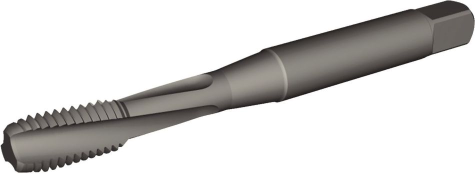

T662 • Machine Screw and Fractional • Form C Semi-Bottoming Chamfer • ANSI
Beyond™ Spiral-Flute HSS-E-PM Taps • Blind Holes
Material Number5565957
ISO Catalog IDT662NC#04-40RH2-AANSI Catalog IDT662NC#04-40RH2-A

  • Chamfer Form C (2–3)Chamfer Form C (2–3)
  • HSS-E-PMHSS-E-PM
  • Manufacturer’s Specs: UNFManufacturer’s Specs: UNF
  • Manufacturer’s Specs: UNCManufacturer’s Specs: UNC
  • Tapping Helix Angle: 10°Tapping Helix Angle: 10°
Drawings for 5565957
GradeKSSM24
[D1-TDZ] Thread Diameter Size#4 - 40
[L] Overall Length 47.7 mm
[L] Overall Length 1.88 in
[L3] Thread Length 14.2 mm
[L3] Thread Length 0.56 in
[L2] Useable Length 17.6 mm
[L2] Useable Length 0.69 in
[D] Adapter / Shank / Bore Diameter3.581 mm
[D] Adapter / Shank / Bore Diameter0.1417 in
[Z] Number of Flutes3
Tap Pitch Diameter LimitH2
  • HSS-E-PMHSS-E-PM
KSSM24
KSSM24
Coated HSS-E-PM, PVD: heat- and wear-resistant high- vanadium, high-cobalt powder metal HSS-E-PM substrate. Coating consists of low friction CrC/C over wear-resistant TiN base layer. Use for tapping titanium and titanium alloys.
  • KSS20 nitride for titanium and titanium alloys.
  • KSSM24 TiN + CrC/C for titanium and titanium alloys.
