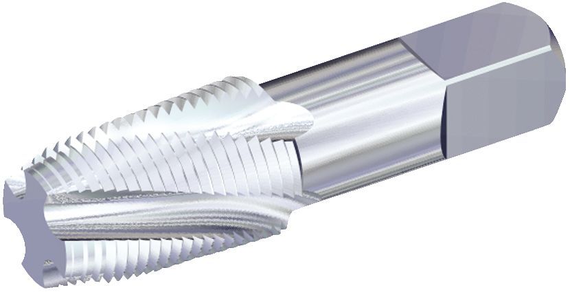

KHSST Taper Pipe • Chamfer 2 1/2 to 3 1/2 Pitches
KHSST Spiral Flute Taper Pipe • Standard Pipe Chamfer 2 1/2 to 3 1/2 Pitches
