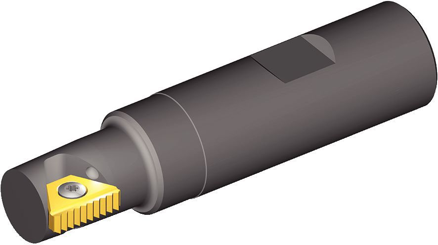

TMS • Thread Milling System • Tapered Shank • Right Hand
Indexable End Mills • One Cutting Edge
Material Number1135826
ISO Catalog ID19X1R023B20STN16TANSI Catalog ID19X1R023B20STN16T
TMS EM WD-TS MM Threading - 1135826 - Kennametal
$415.92/each
Drawings for 1135826
[D1] Effective Cutting Diameter19 mm
[D1] Effective Cutting Diameter0.748 in
[D] Adapter / Shank / Bore Diameter20 mm
[D] Adapter / Shank / Bore Diameter0.7874 in
[D2] Maximum Body Diameter15 mm
[D2] Maximum Body Diameter0.5906 in
[L] Overall Length 85 mm
[L] Overall Length 3.3465 in
[L3] Usable Length23 mm
[L3] Usable Length0.9055 in
Number of Inserts1
Max RPM24350
Gage InsertSTN16
Torque Insert Screw2.3
  • Cutting diameter ranges from 10–30mm.
  • For internal and external threading on most types of workpiece materials.
  • One tool is used for both right- and left-hand threads.
  • All cutters have through-coolant capability.
  • Utilizes inserts with various profiles and pitches.
