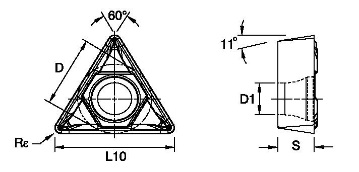

    Drawings for 5538899
    Material Number5538899
    ISO Catalog IDTPMT090204FP
    ANSI Catalog IDTPMT18151FP
    GradeKCP10B
    [D] Insert IC Size5.55 mm
    [D] Insert IC Size0.219 in
    [L10] Insert Cutting Edge Length9.63 mm
    [L10] Insert Cutting Edge Length0.3791 in
    [S] Insert Thickness2.38 mm
    [S] Insert Thickness0.0938 in
    [Rε] Corner Radius 0.4 mm
    [Rε] Corner Radius 0.016 in
    [D1] Insert Hole Size 2.5 mm
    [D1] Insert Hole Size 0.098 in
    KCP10B
    KCP10B
