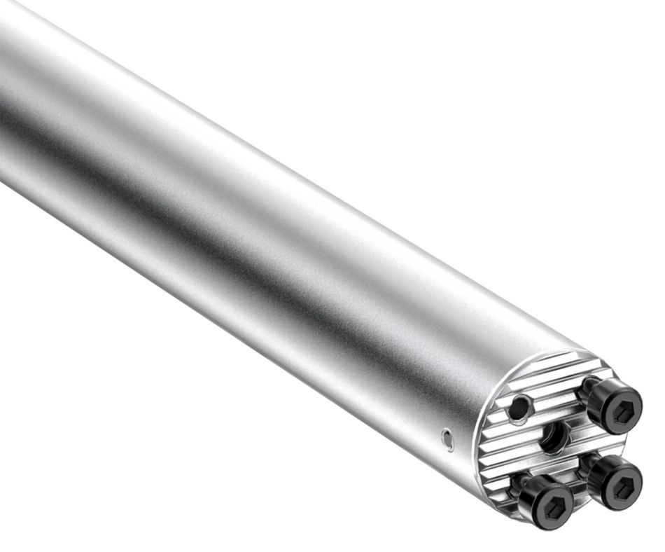

    • Boring with extended overhangs up to 10 x D
    • No tuning required
    • Lighter weight bolt on heads
    • Serrated interface for a secure connection
