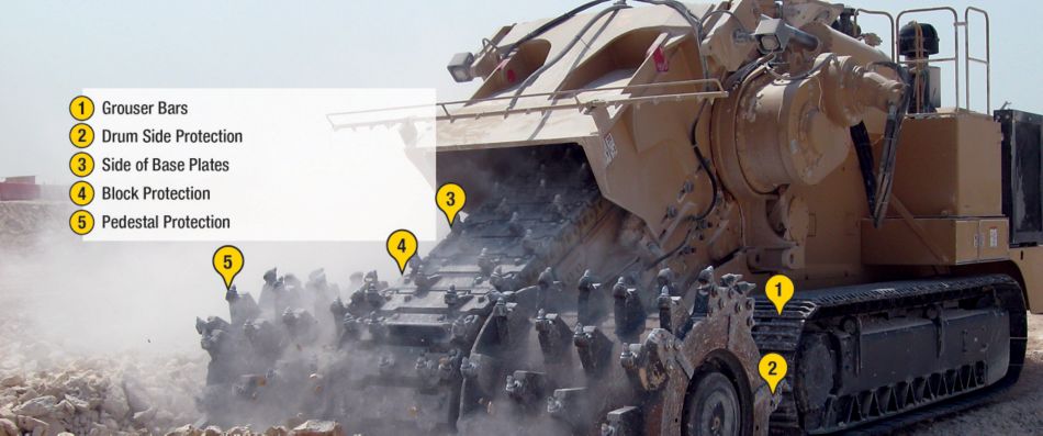

Surface Miner with Call Outs for Grouser Bars, Drum Side Protection, Side of Base Plates, Block Protection, and Pedestal Protection

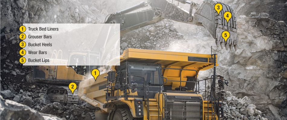

Excavator and Dump Truck with label callouts for Truck Bed Liners, Grouser Bars, Bucket Heels, Wear Bars, and Bucket Lips
