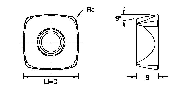

Drawings for 6033254
Material Number6033254
ISO Catalog IDXDPW120515SRD
ANSI Catalog IDXDPW120515SRD
GradeKCPM40
[D] Insert IC Size12.7 mm
[D] Insert IC Size0.5 in
[LI] Insert Length 12.7 mm
[LI] Insert Length 0.5 in
[S] Insert Thickness5.56 mm
[S] Insert Thickness0.219 in
[Rε] Corner Radius 1.5 mm
[Rε] Corner Radius 0.059 in
Average Chip Thickness [HM]0.25 mm
Average Chip Thickness [HM]0.01 in
[RT] Theoretical Corner Radius Programing2.78 mm
[RT] Theoretical Corner Radius Programing0.109 in
