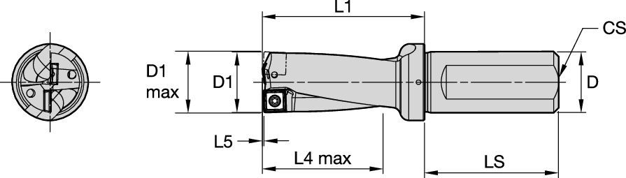

Drawings for 7030671
Material Number7030671
ISO Catalog IDDFPR1813R2WB200
ANSI Catalog IDDFPR1813R2WB200
[D1] Drill Diameter M 46.05 mm
[D1] Drill Diameter M 1.813 in
[D1MAX] Drill Diameter Maximum47.0502 mm
[D1MAX] Drill Diameter Maximum1.8524 in
[L5] Drill Point Length1.2 mm
[L5] Drill Point Length0.047 in
[L1] Insert Gage Length 122.1 mm
[L1] Insert Gage Length 4.8071 in
[L4] Maximum Drilling Depth 92.1 mm
[L4] Maximum Drilling Depth 3.626 in
[LS] Shank Length 80 mm
[LS] Shank Length 3.1496 in
[D] Adapter / Shank / Bore Diameter50.8 mm
[D] Adapter / Shank / Bore Diameter2 in
[CS] Coolant Supply Size1/4-18 NPT
Internal Face Catalog Gage Insert 1DFPR150508__O
Internal Face Catalog Gage Insert 2DFPR170508__I

  • Versatile indexable drill, covering many workpiece materials.
  • For straight hole drilling, inclined entries and exits, interrupted cuts, and rough casted, forged or welded entry surfaces.
  • Two eccentric positioned coolant channels for higher coolant volume, providing higher metal removal rates, tool-life, and productivity.
  • Helical flutes for perfect chip evacuation.
  • Drill body provides high stiffness, eliminating noise and vibrations, resulting in best-in-class hole size accuracy and hole quality.
  • The X-offset feature enables diameter adjustment within the machine, and applications on lathe machines.
