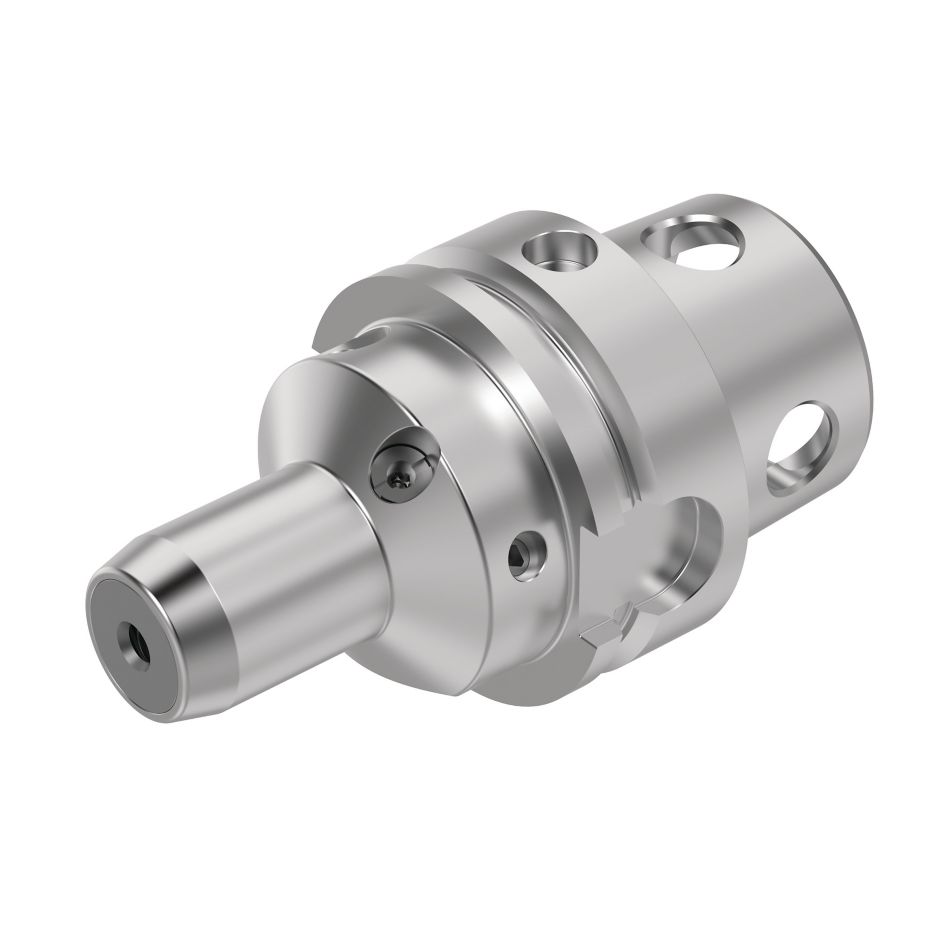

HC KM4X Metric
High-Performance Line • KM4X™
Material Number6480501
ISO Catalog IDKM4X63HC10150MANSI Catalog IDKM4X63HC10150M
Hydraulic Chucks High-Performance Line • KM4X™
$1,094.21/each
  • Axial Adjustment - SideAxial Adjustment - Side
  • Accuracy - 3μm or LessAccuracy - 3μm or Less
  • Balance - G 2.5@25,000 min-1Balance - G 2.5@25,000 min-1
  • Shank: KM4X™Shank: KM4X™
Drawings for 6480501
[D1] Adapter / Shank / Bore Diameter10 mm
[D1] Adapter / Shank / Bore Diameter0.394 in
[D2] Body Diameter 1 Workpiece Side 29.64 mm
[D2] Body Diameter 1 Workpiece Side 1.167 in
[D21] Body Diameter 2 Workpiece Side49.85 mm
[D21] Body Diameter 2 Workpiece Side1.963 in
[L1] Gage Length150 mm
[L1] Gage Length5.906 in
[L2] Usable Length 105 mm
[L2] Usable Length 4.134 in
[L9] Clamping Length 31 mm
[L9] Clamping Hole Length 1.22 in
[V] Adjustment Range 10 mm
[V] Adjustment Range 0.394 in
Actuation Screw ID Drive Size5 mm
Stop Screw ID Drive Size2.5 mm
Weight Kilograms1.48
