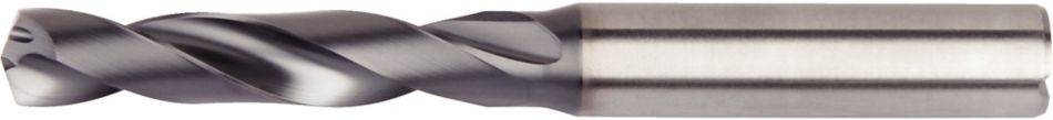

KenDrill™ KMH • 3 x D • Internal Coolant • Straight Shank • Metric
Solid Carbide Drill for Hard Materials
Material Number6359022
ISO Catalog IDB951A05000ANSI Catalog IDB951A05000

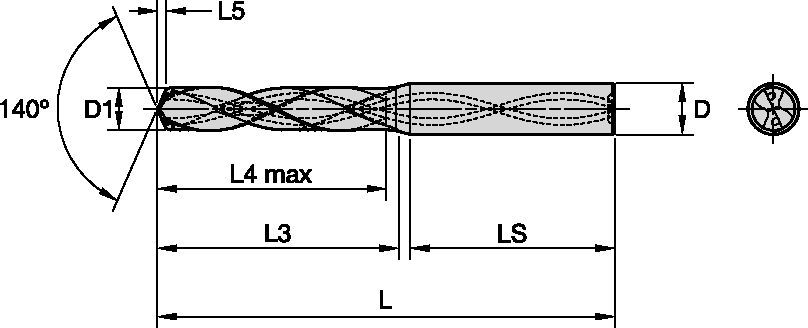

GradeKCH15
[D1] Drill Diameter M 5 mm
[D1] Drill Diameter M 0.1969 in
[L] Overall Length 66 mm
[L] Overall Length 2.6 in
[L3] Flute Length 28 mm
[L3] Flute Length 1.1 in
[L4] Maximum Drilling Depth 20 mm
[L4] Maximum Drilling Depth 0.79 in
[L5] Drill Point Length1.01 mm
[L5] Drill Point Length0.0398 in
[LS] Shank Length 36 mm
[LS] Shank Length 1.4173 in
[D] Adapter / Shank / Bore Diameter6 mm
[D] Adapter / Shank / Bore Diameter0.2362 in

KCH15
KCH15
Composition: PVD AlTiN coated, fine-grain carbide.
Application: First choice for hardened steels between 48 and 55 HRC as well as case-hardened workpieces with hole depths >3 x D.
  • The all new KMH solid carbide drills are engineered for hard material applications up to 65 HRC. The B95_ drill series with through coolant and 140° point is designed for deeper applications.
  • KMH Point Design with curved cutting edge with corner chamfer for maximum corner stability in hard materials. It avoids chipping on cutting edge thus pre-mature wear.
  • Special flute design with strong web to increase the strength of the drill in tough applications with short chips. B95_ series with 30° helix angle to improve chip evacuation in higher length-to-diameter ratios.
  • KCH15 on B95_ with its higher toughness supports edge strength at increased rake angles, which are applied to improve chip evacuation in higher L/D ratios. It carries a high temperature and shock resistance AlTiN coating for machining hardened material to increase tool life.
