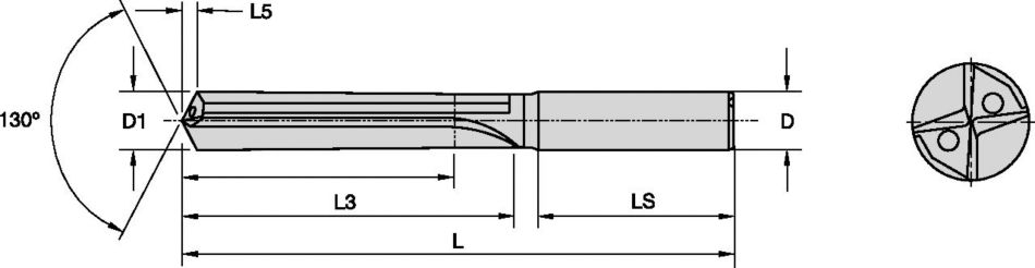

Drawings for 1198716
Material Number1198716
ISO Catalog IDB411A23000
ANSI Catalog IDB411A23000
GradeKF1
[D1] Drill Diameter M 23 mm
[D1] Drill Diameter M 0.9055 in
[L] Overall Length 184 mm
[L] Overall Length 7.2441 in
[L3] Flute Length 126 mm
[L3] Flute Length 4.9606 in
[L4] Maximum Drilling Depth 98 mm
[L4] Maximum Drilling Depth 3.8583 in
[L5] Drill Point Length5.09 mm
[L5] Drill Point Length0.2004 in
[LS] Shank Length 56 mm
[LS] Shank Length 2.2047 in
[D] Adapter / Shank / Bore Diameter25 mm
[D] Adapter / Shank / Bore Diameter0.9843 in
