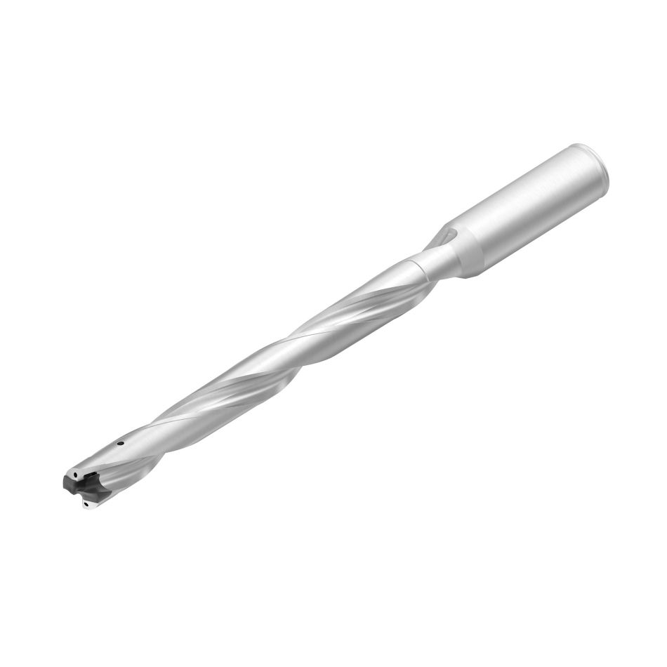

KSEM™ • Drill Body • 10xD • SS Shank • Inch
Modular Drilling • Straight Shank (SS)
Material Number1730118
ISO Catalog IDKSEM1156R10SS125ANSI Catalog IDKSEM1156R10SS125
KSEM Round Shk 10xD Inch Holemaking - 1730118 - Kennametal
$858.69/each
Drawings for 1730118
[D1] Drill Diameter M 29.37 mm
[D1] Drill Diameter M 1.1563 in
[D1MAX] Drill Diameter Maximum29.87 mm
[D1MAX] Drill Diameter Maximum1.176 in
[L4/D1] Length/Diameter Ratio10
[L] Overall Length 409.575 mm
[L] Overall Length 16.125 in
[L3] Flute Length 323.009 mm
[L3] Flute Length 12.7169 in
[L4] Maximum Drilling Depth 293.688 mm
[L4] Maximum Drilling Depth 11.5625 in
[L5] Drill Point Length4.518 mm
[L5] Drill Point Length0.1779 in
[LS] Shank Length 82.55 mm
[LS] Shank Length 3.25 in
[D] Adapter / Shank / Bore Diameter31.75 mm
[D] Adapter / Shank / Bore Diameter1.25 in
[SSC] Insert Seat Size7
  • The central locking screw mechanism ensures secure clamping of the insert, resulting in process safety and long tool life for both the drill body and the insert
  • Internal coolant supply directly to the cutting zone, for extended tool life and efficient chip evacuation
