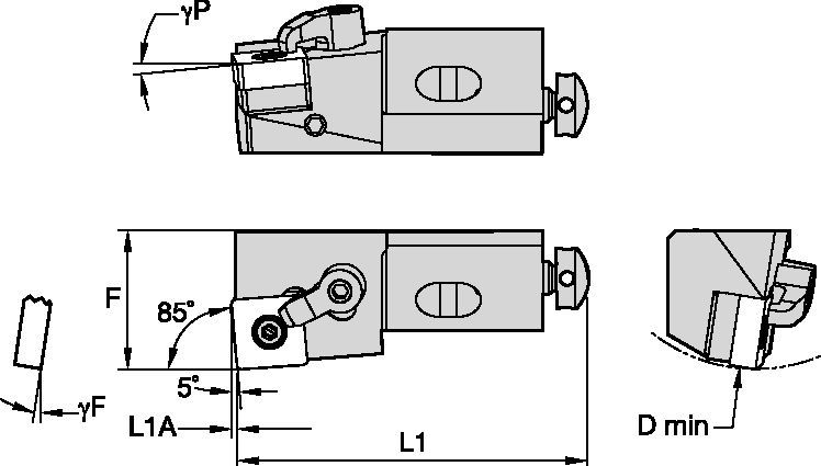

Drawings for 1098691
Material Number1098691
ISO Catalog IDMSYNL20CA15
ANSI Catalog IDMSYNL20CA15
[DM] Minimum Bore Diameter 70 mm
[DM] Minimum Bore Diameter 2.7559 in
[F] F Dimension 25 mm
[F] F Dimension 0.9843 in
[L1] Tool Length 70 mm
[L1] Tool Length 2.7559 in
[L1A] L1 A Dimension 1.26 mm
[L1A] L1 A Dimension 0.0496 in
[GAAP] Axial Rake Angle5
Gage InsertSN..150612/SN..543
